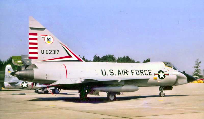

Re: Flaps on delta wing aircraft
When the aircraft is parked on the ramp for extended periods of time and hydraulic pressure bleeds down, would the elevons not droop to an extent?
This 102 appears to have some droop on the elevons
They are not dropped for added lift for take off obviously...
and obviously not on landing either...
but it is not unheard of to see them with drooped elevons when parked on the ramp
but obviously when the bird is powered up and hydraulics pressurized, the elevons go to what ever position the stick is at
