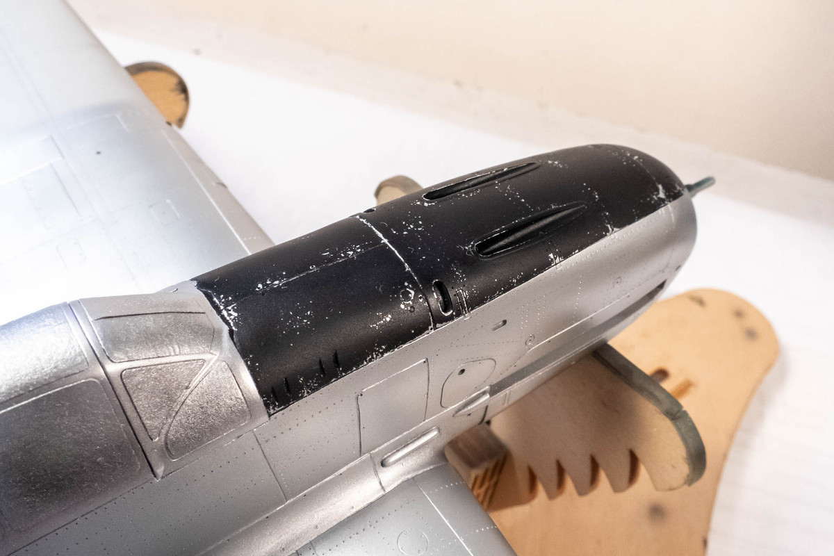

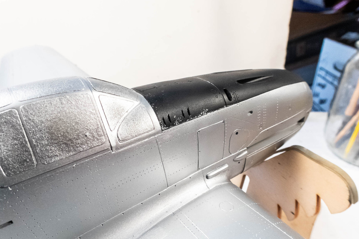

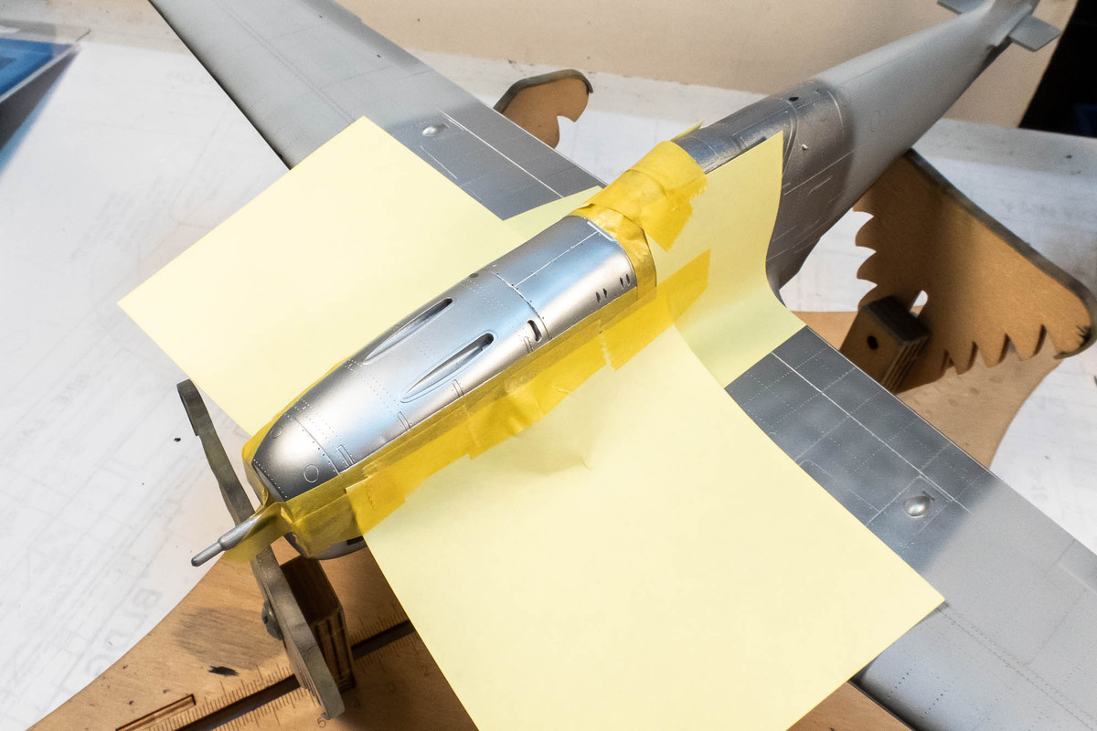

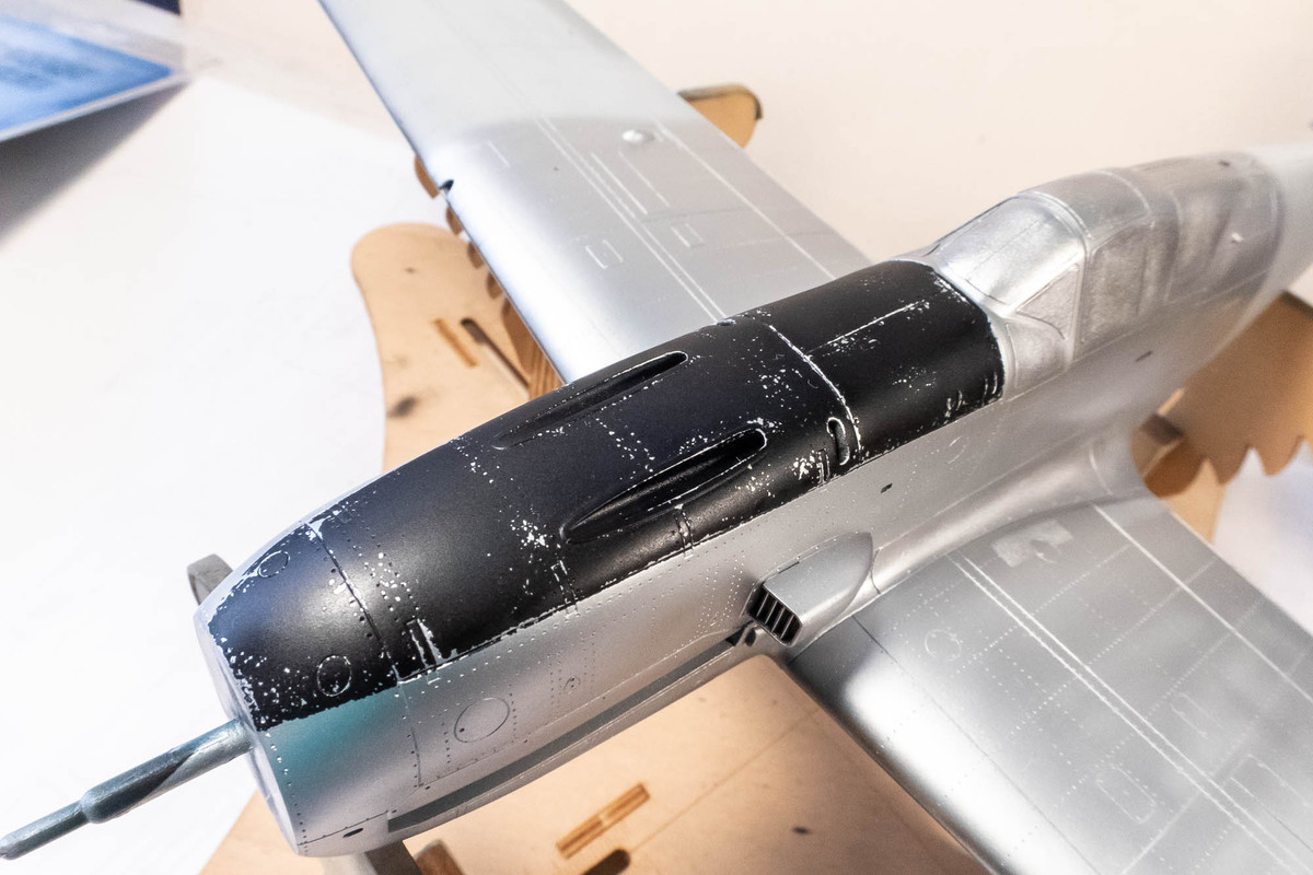

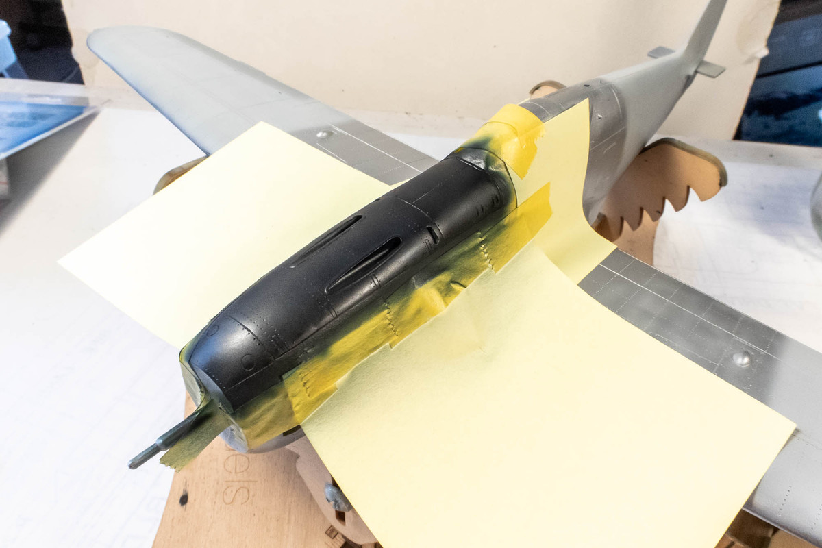

Thanks guys! After the Tamiya AS-12 has been sprayed on the top parts, I am going to isolate the black anti-glare panel first. Hairspray chipping can be a very finicky technique for me. Right now, I am comfortable in chipping one paint layer over the hairspray and I thought the best way to do the anti-glare panel was to paint it first, chip it, seal it with a gloss coat and then mask it off when it comes time to paint the darker camo color on top.
The anti-glare panel is masked off with Tamiya tape and Post-Its and then a couple of layers of hairspray are applied and allowed to dry.

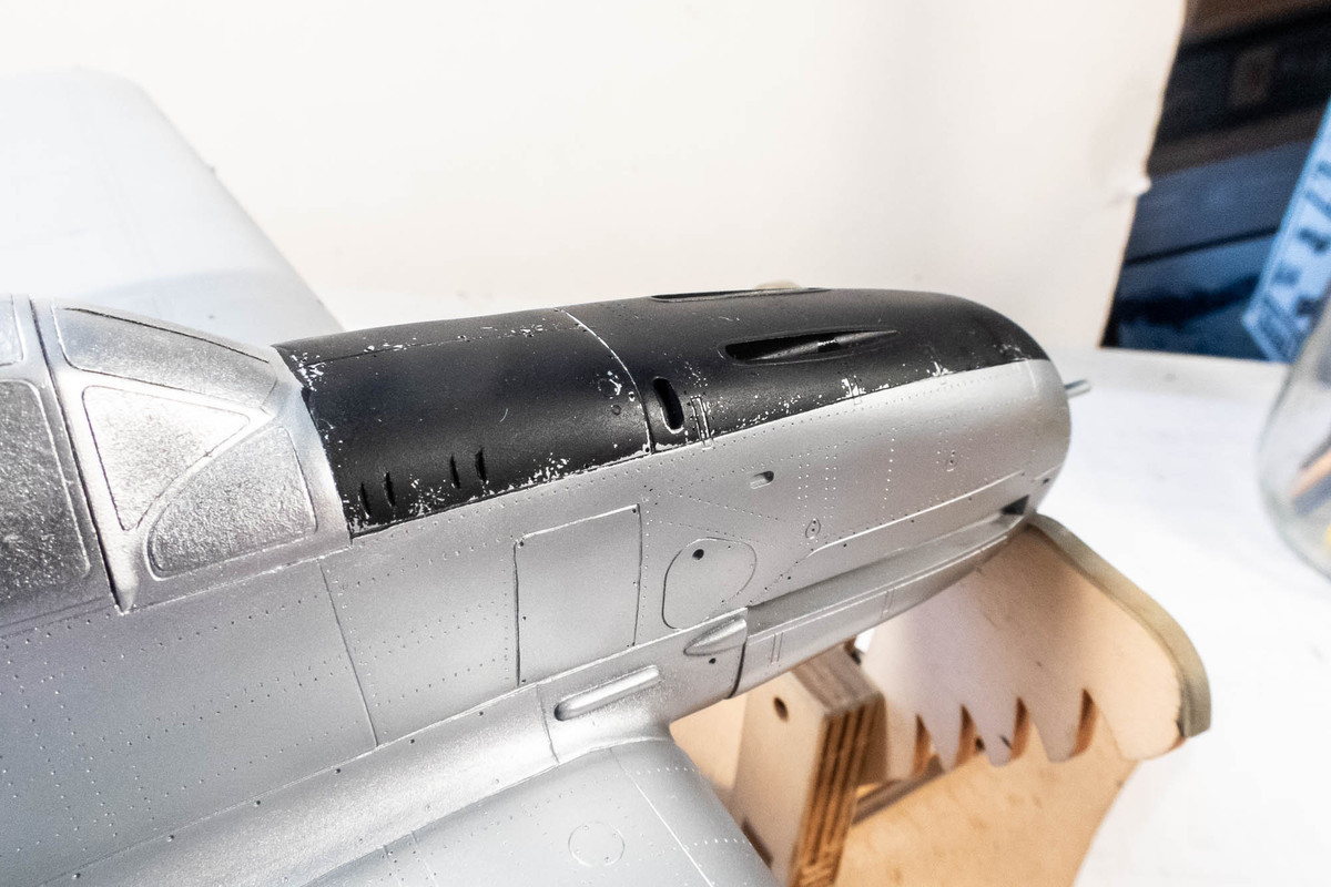

The anti-glare panel is actually a blue-black, a 50:50 mix of Tamiya Flat Black XF-1 and Tamiya Blue X-4. I've gotten better hairspray chipping results with flats rather than glosses and I think that has to do with the relative porosity of a flat finish versus a gloss.
The masking is removed and I'm ready to start chipping. I use a small stiff-bristled paint brush dipped in water and start rubbing it back and forth over a small area. As the water soaks down to the hairspray, the paint layer above becomes unstable and starts flaking off. I do this in very small, focused areas. As soon as I start to get some good chipping, I STOP and blot the area dry and move to the next area. If an area gets too wet, the paint can really start coming off in bunches and you can't undo it... better to work slowly and deliberately.
So I work my way around the anti-glare panel. I try to be somewhat systematic, focusing the chipping effects along the panel lines, hinges and rivet lines instead of being totally random.
Here is the anti-glare panel after hairspray chipping has been completed. I'm going to let this dry out for a few hours and then seal it with light mist coats of Alclad Aqua Gloss thinned with 90% iso alcohol. Typically, I thin my Aqua Gloss with Mr Leveling Thinner but the last thing I want with this chipped layer is for the thinned gloss to cut down into the hairspray and create havoc in the form of spider-webbing.

I should clarify... what I mean is spider web cracking. Like a crackling effect due to the interaction between the hot thinner and the hairspray layer. It's happened to me a few times so I've careful to avoid it.

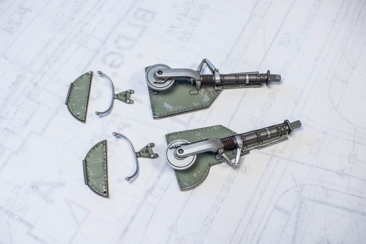

Some work on the landing gear...

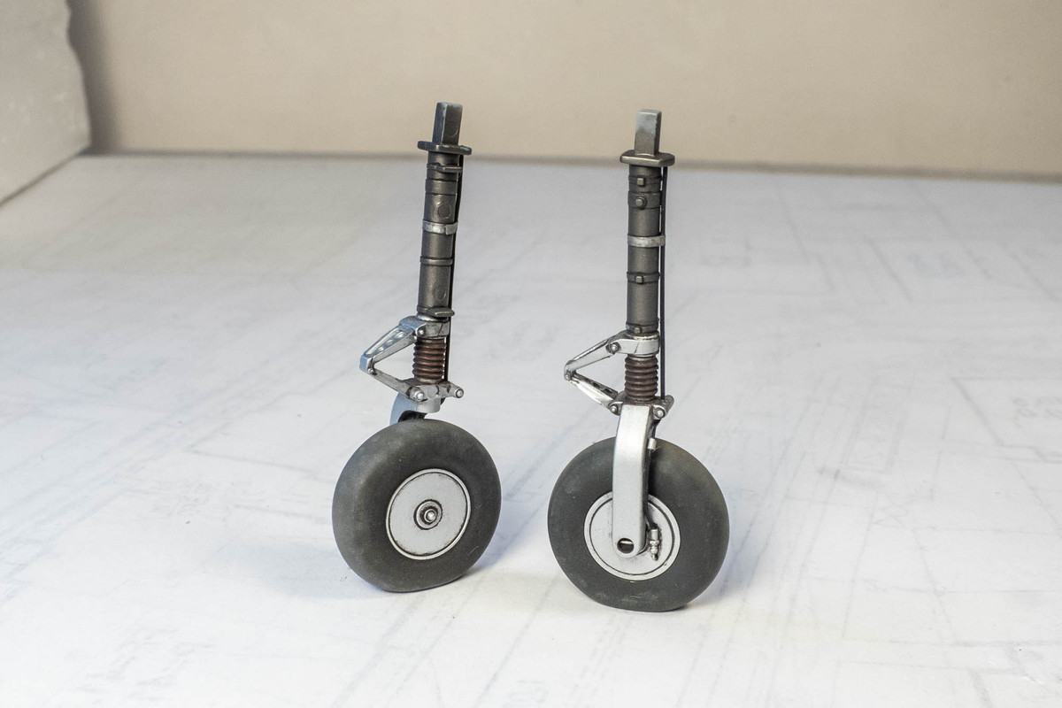

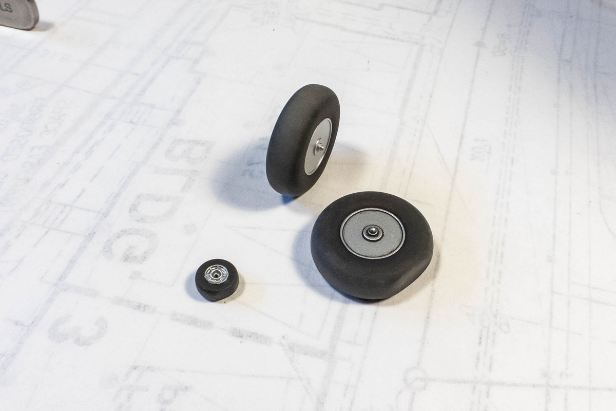

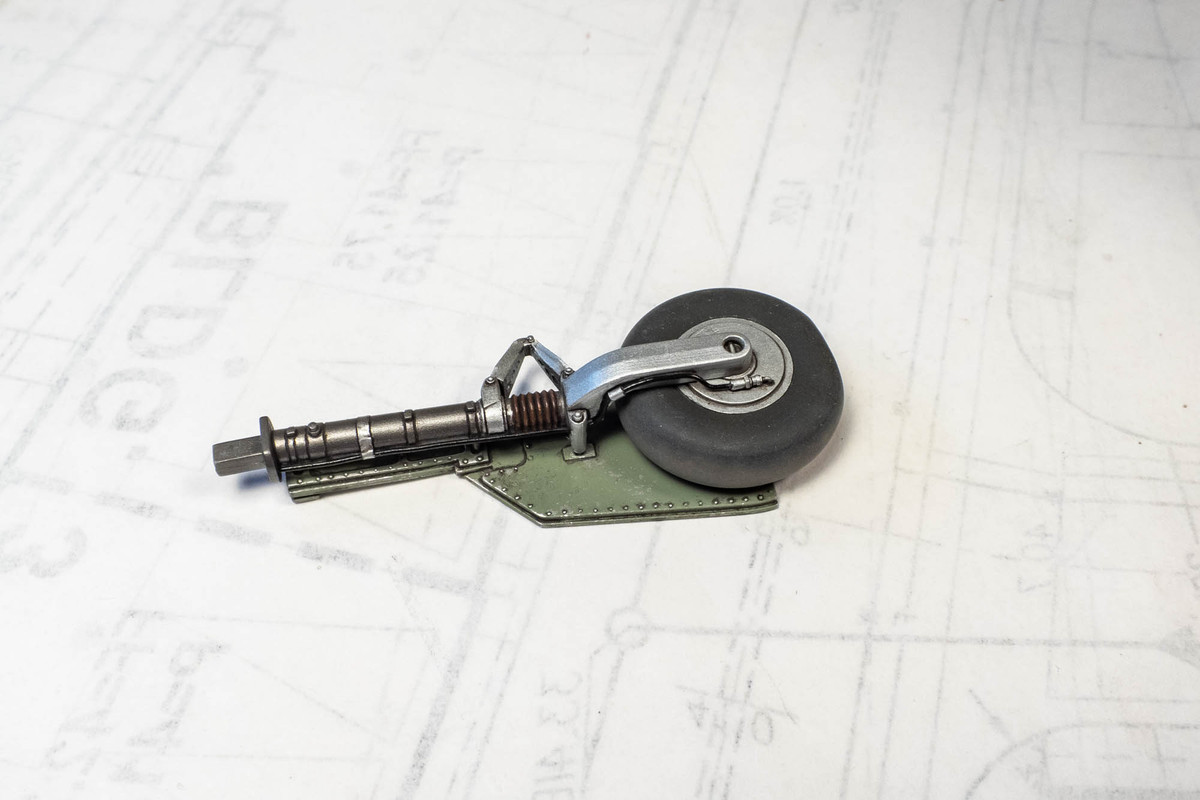

The wheels have been painted. In addition to lightening the color progressively from sidewalls to contact surface, I used a tan wash to stain the tires more... but it looks all but invisible in this photo...

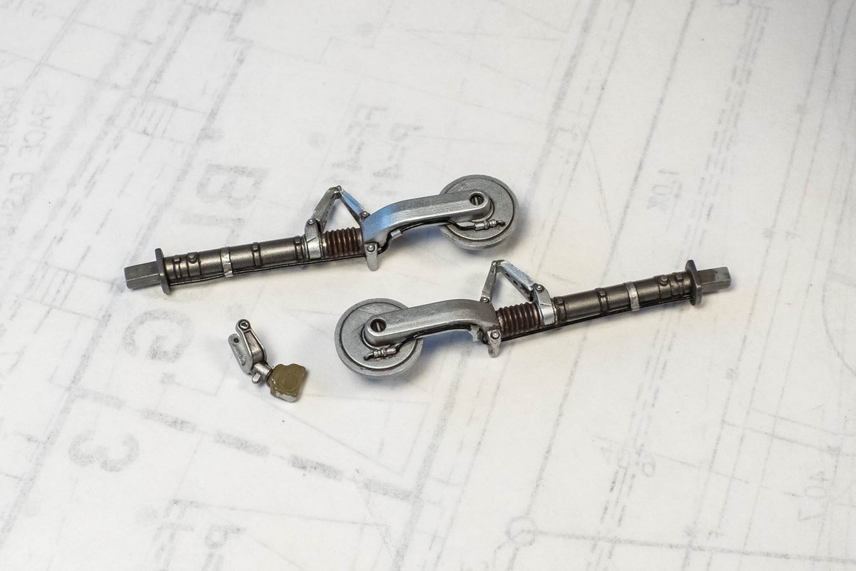

The landing gear legs have been painted. I've applied a dark pastel wash but they are still glossy and need a flat coat.

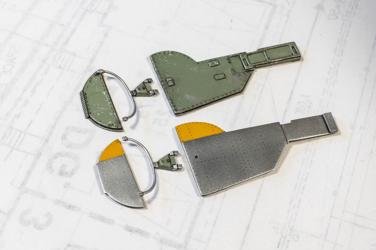

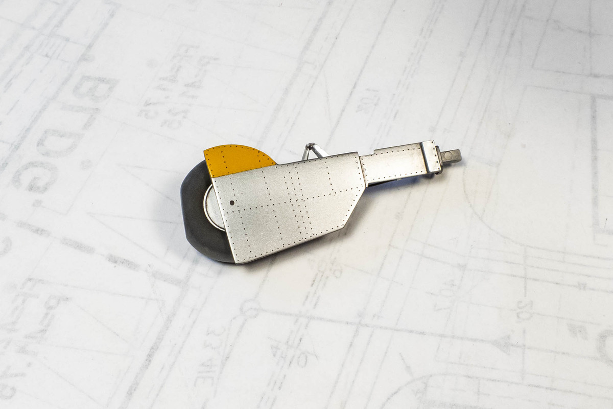

Same deal with the landing gear covers.
Re: 1//32 Hasegawa Ki-61-1 Tei Hien
The interior sides of the landing gear covers and the legs have been given a flat coat. I've been using Model Master Acryl Flat Clear, which may be out of production now?

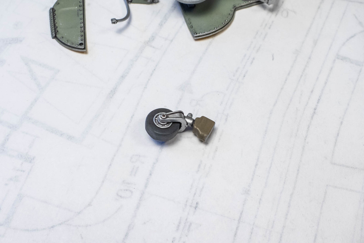

Here is the tail wheel. I've replaced the plastic pins with a removable axle made of brass tubing so that I could insert the wheel after the tail gear halves were glued together. The axle makes the tail wheel rotatable so I can align the flat spot later on.
Just to verify that I matched the inner landing gear covers to the correct side.

Brandons_Iron wrote: Mon Jul 17, 2023 2:41 pm Wow, what a great idea for the tires. I will have to add that to the arsenal. Cool beans. :shoutout:
Thank you sir! I wanted a way to impart some discrete edged stains to my tires since the airbrush could only give airbrushed looking effects. So I used the normally avoided issue of pastel washes sometimes staining flat finishes with tide marks as a way a way to do this. I've used this on a few build now...
