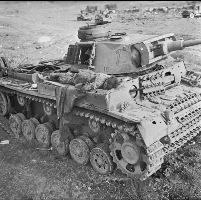

KennyX wrote: Fri Jul 12, 2024 8:23 am Thank you for sending that my way, Carlos.
I wonder how true to life those photos are, color-wise. I recall our friend Bruce mentioning to me that Kodachrome remains pretty faithful to the original color of the subject of the photo. but I know next to nothing about that stuff.
Anyway, the tank in the photo looks to be more green in the mix, paint-wise. But cloud cover could cause that shift. So could dirt. I look at some of the highlights though and then look at the color of my model, and I say to myself "Good enough for government work!"
Having said that, have a look at the turret number. Maybe the often thick and unwieldy Tamiya decals really *DO* a good job representing them HAHA! It actually makes me want to explore painting the turret numbers on myself. Its something to think about.
Thank you for the great photo! I love it and I'll be using it moving forward with my DAK stuff. And as it happens, if you ever find more to pass my way, please do, or if you know a good source. I'd like to bring more realism and accuracy into my builds moving forward.
You touched on a few things that I can answer here. But I certainly defer to Bruce’s expertise in regards to photography.
First off, the Panzer III in the photo is from the first Tiger unit sent to Africa in late 1942, so it pre dates the use of Dark Yellow. That unit’s stalking Tiger insignia is visible by the driver’s vision port. It’s probably in the 1942 “Tropen” colors of RAL 8020 or possibly RAL 7027.
The Germans applied their turret numbers usually by hand painting so painting your own is a great idea for a better look. I find the Life archives to be a great source of original WWII color photos, but it’s clunky to search and navigate. I have a few different photos of different armor that I’ve saved up over the years that I’ve found while browsing. Hopefully some of them may be of some use to you.

Re: Tamiya Panzer III, Ausf L Tunisia 1943
Post by KennyX »
Carlos,
Thank you for the input!! That helps guide my preliminary decision making with my Panzer IV X Exorcist project I’ll be starting construction on, tomorrow.
The kit calls the dark yellow- likely RAL 8020. But when scrutinizing the reference photo, I see subtle hints on camo. So I did some digging and learned about the Tropen II camo scheme, which #215 very well may have worn:
If I’m understanding things correctly, in the beginning of ‘42, German armor was Dunklegrau, and then oversprayed later with Tropen II Camo scheme. Would that apply to a Panzer marauding around El-Alamein Egypt, at the time?

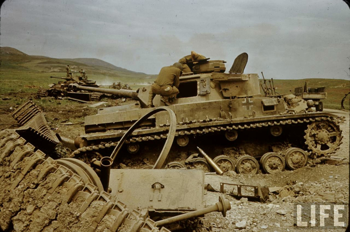

KennyX wrote: Sat Jul 13, 2024 9:36 am So Carlos, if a Panzer was serving in El-Alamein Egypt in Autumn of ‘42, then he’d be wearing the RAL 8020, RAL 7027 in a field applied fashion, then? And we wouldn’t be working with a Panzer Grey base coat? I hope that the case at least, as I dislike using many base coats HAHAHAA
Correct, no Panzer Gray base coat. Here is my note on DAK colors for 1942
1942:
RAL 8020 base, 1/3 disruptive pattern RAL 7027. Alternate of RAL 8020 with RAL 7021 pattern or over RAL 7021 base
Here is a 15th Panzer Mk.IV G after El Guettar in Tunisia in spring 1943. It looks to have the 8020/7027 scheme. Also notice how the interior of the hatches are gray, which was pretty standard on DAK vehicles, even if painted at the factory.
