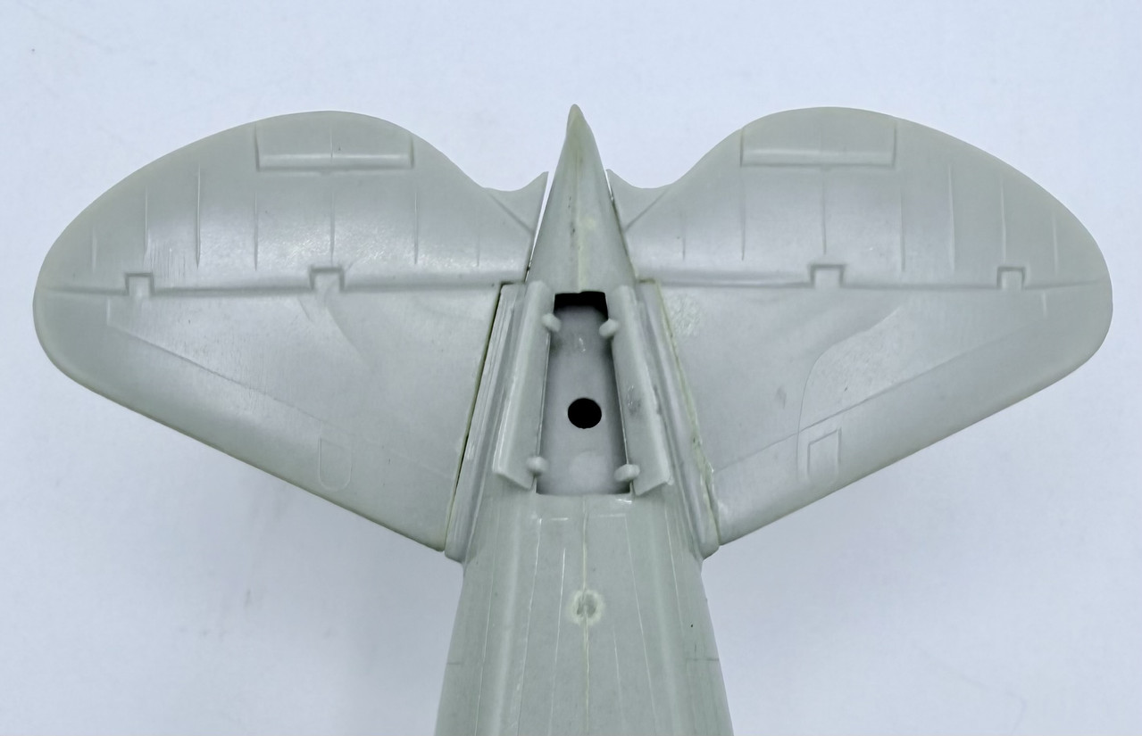

Yeah I have to say I don't know a huge amount about the aircraft, but you can see the lineage to Thunderbolt in those photos, especially around the tail.

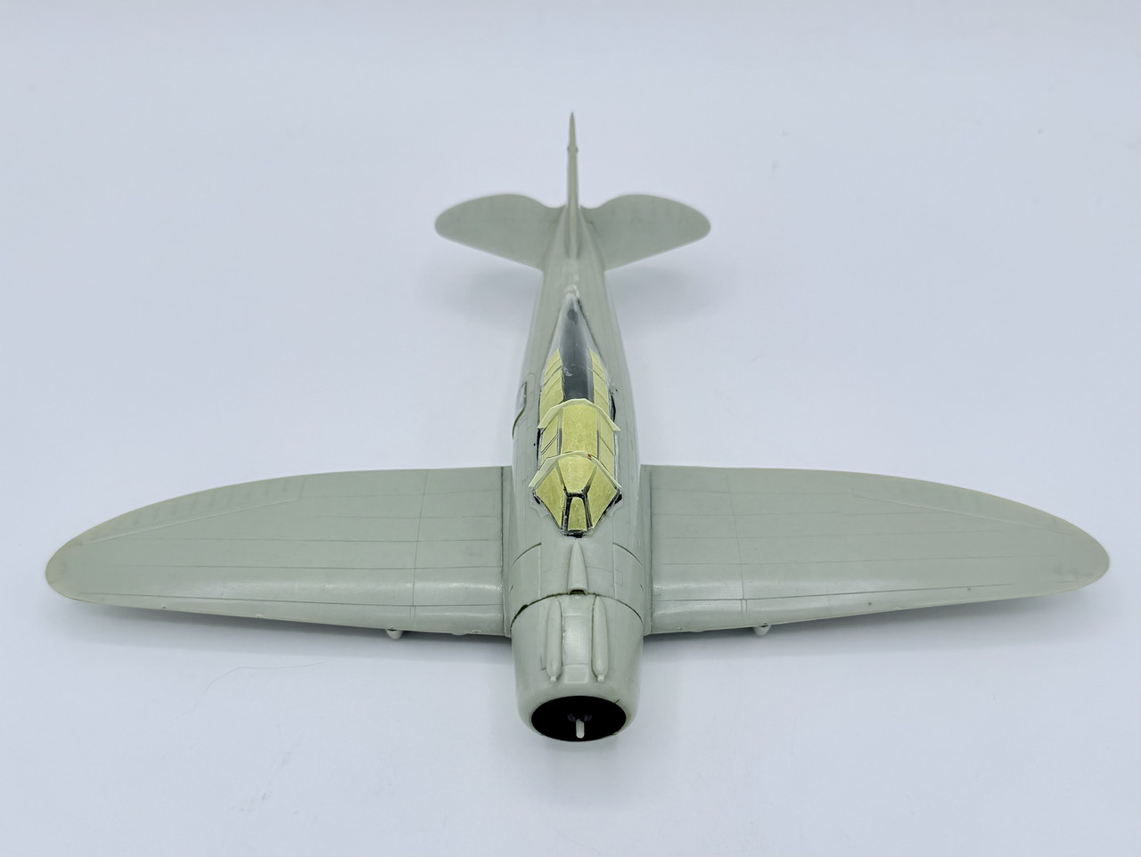

Ok, so many progress photos today of work since I pulled this one off the shelf of doom last week.
Long story short, one reason this was sidelined is that I was trying to correct the kits razorback section of the rear canopy and screwed it up. The kit part is too rounded in profile at the rear. So I had to get ahold of a vacuform replacement. It’s an improvement, but still misses the correct shape. But I sure could not do any better. So here is the replacement Squadron vac canopy now cut out, masked, and glued in place. I also glued the engine cowling in place

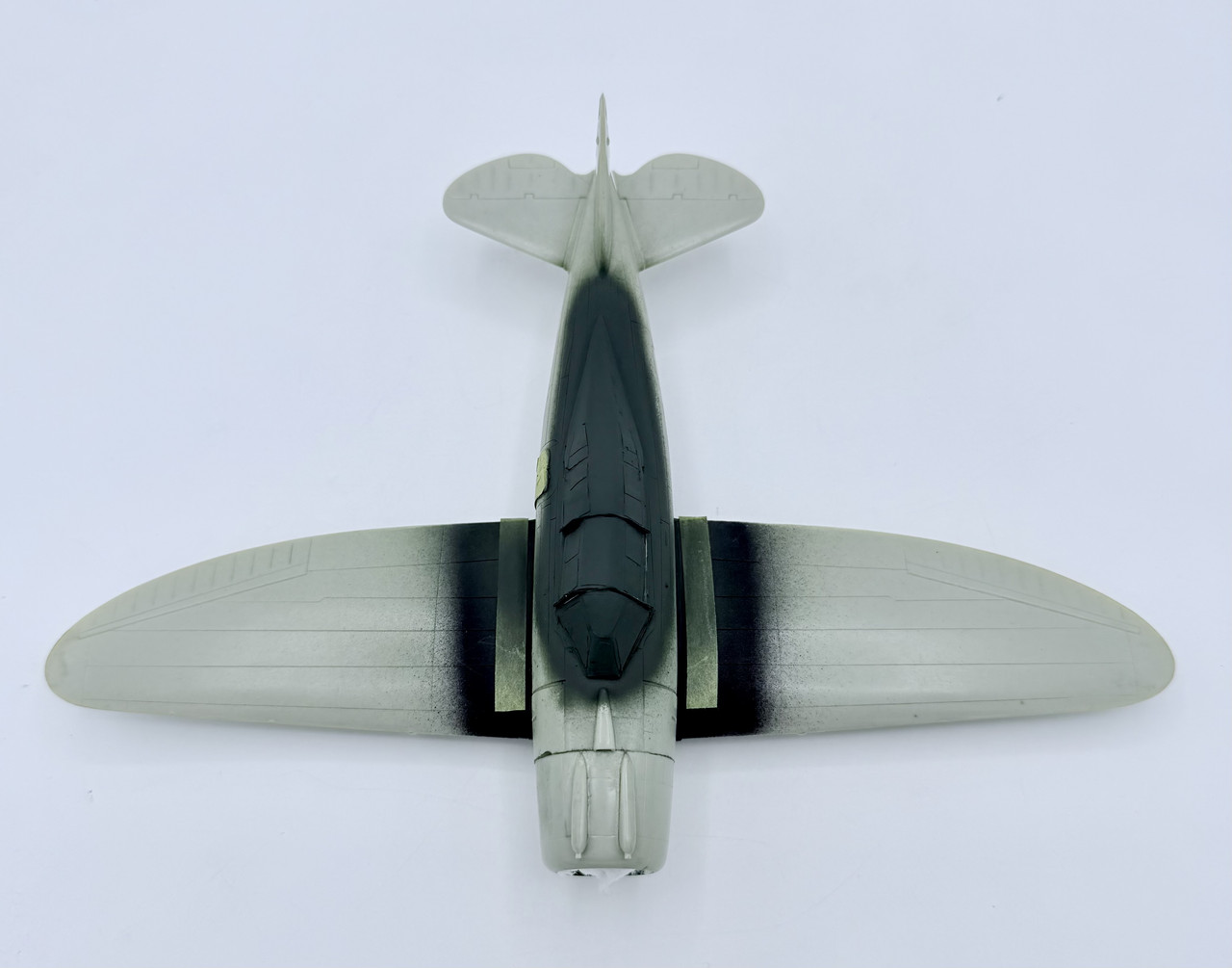

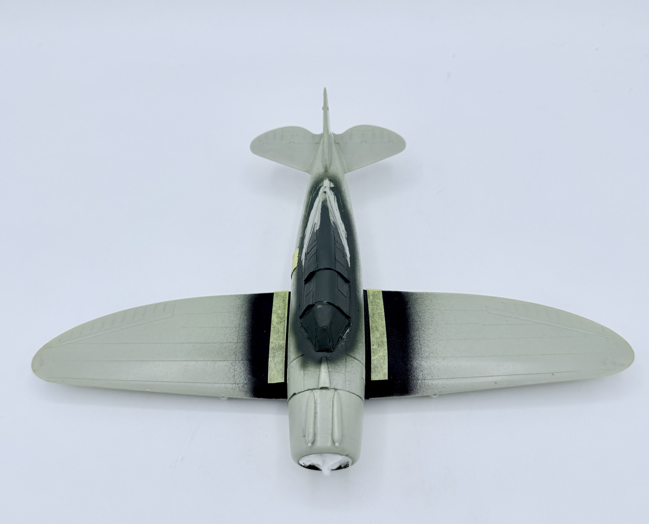

I then airbrushed on some flat black for the wing walk areas and the interior color that I chose and previously used, Humbrol Bronze Green onto the canopy framing. I had to go back and sand some portions of the canopy rear as there was a noticeable step when the paint dried.
And after the sanding, another coat of the Bronze Green

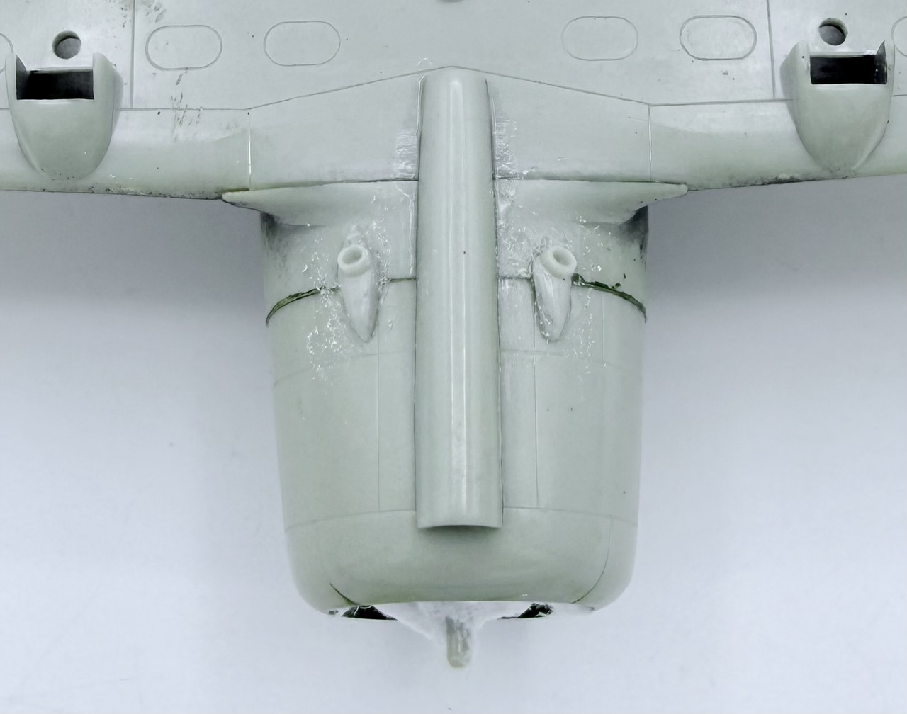

I later glued the last bits into place that would not break off due to handling, the exhaust stub pipes and the tail wheel doors

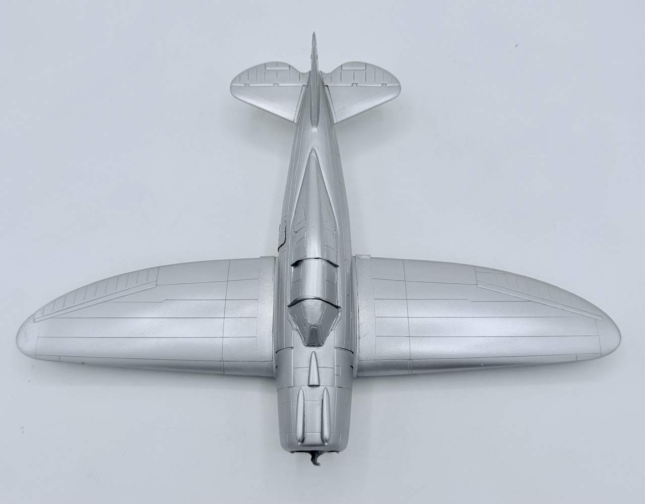

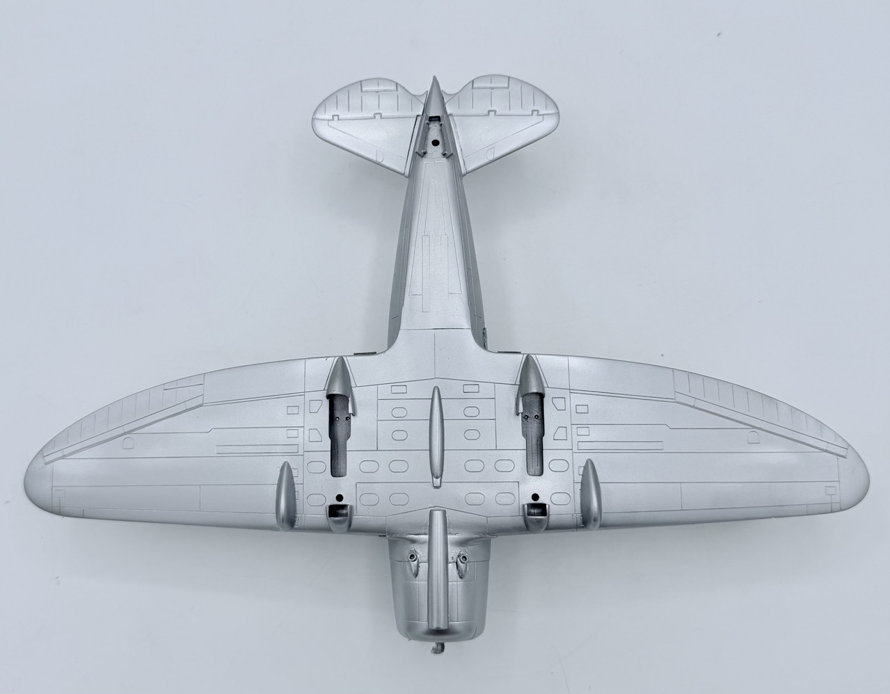

After those had time to dry, I gave the overall airframe a base coat of Floquil Old Silver
I’m gonna let the Old Silver dry at least a day or two before I airbrush on Olive Drab 41 and Neutral Gray wartime colors. Since these aircraft were not painted properly, photos show them heavily worn and I want to replicate that look…
