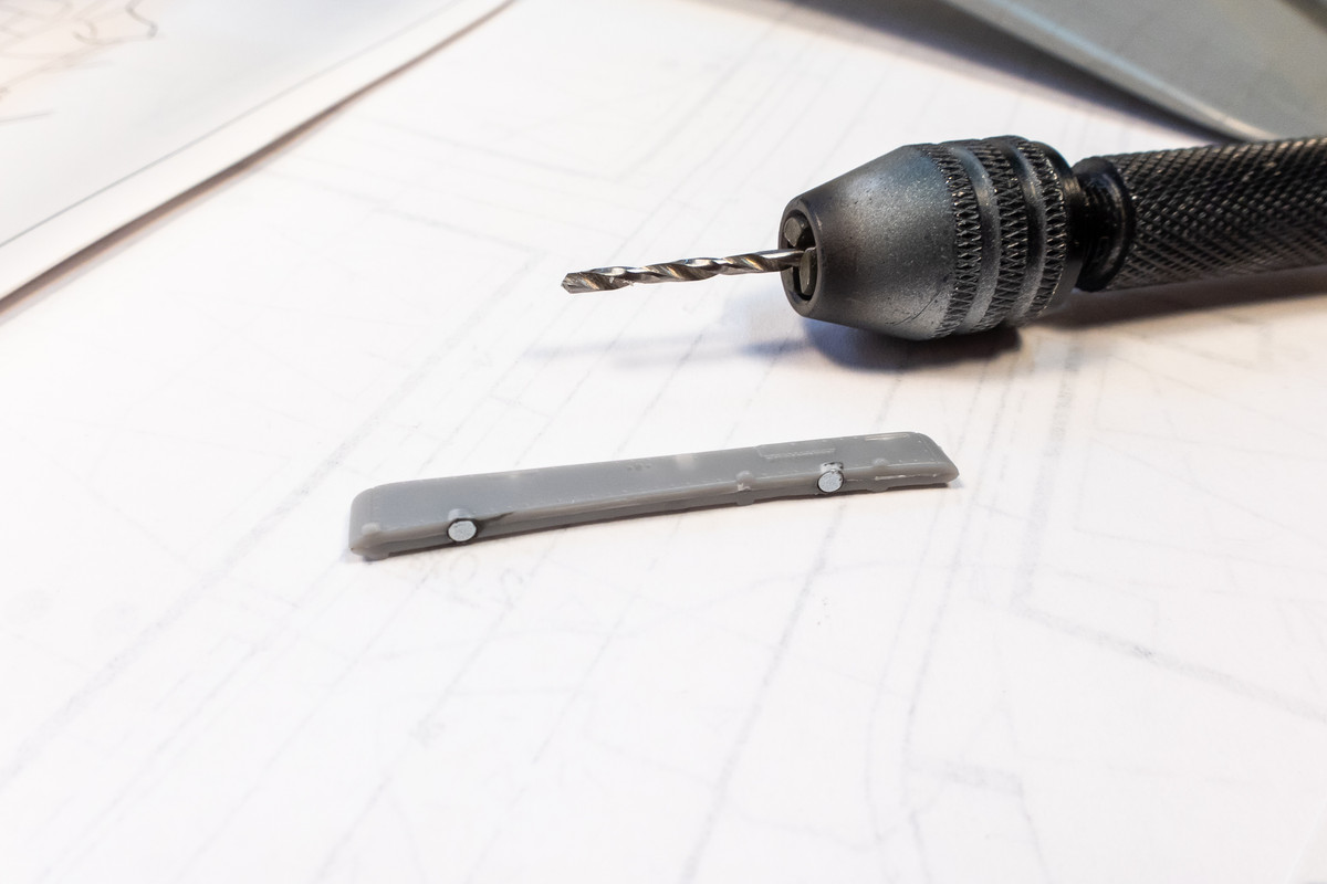

I forgot to cut out the slots in the wing bottoms to accommodate the drop tank racks. That got me thinking about a better way... using magnets to attach the racks and keep the wing bottoms completely clean otherwise. So I drilled a couple of holes and dropped in the smallest of the magnets. These are 1/16" (0.0625mm) in diameter.
The racks are BARELY thick enough to accommodate the magnets.
Voila... detachable drop tank racks!

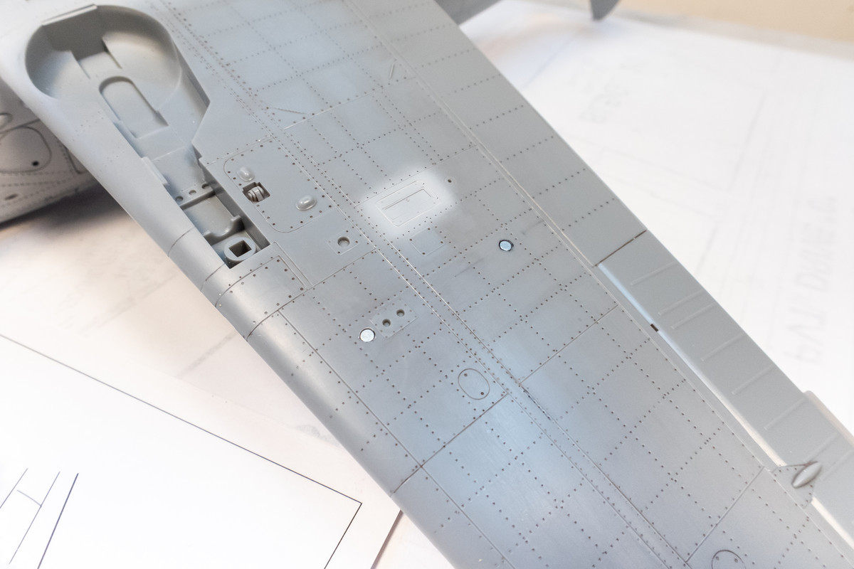

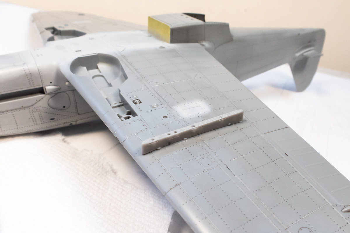

I got the magnets on EBay. I guess they are used by Warhammer figure painters.
Here is the wing after the magnets have been covered with putty.
Two magnets are enough to hold the rack + drop tank securely.

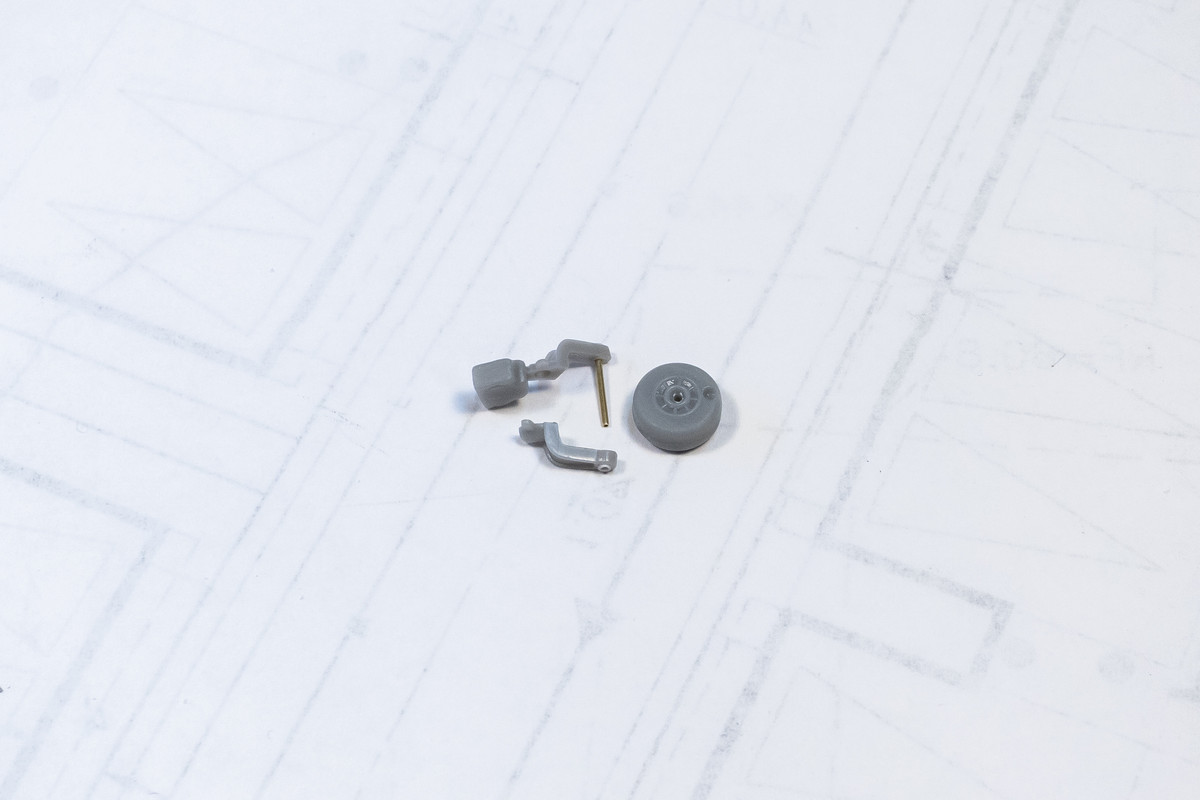

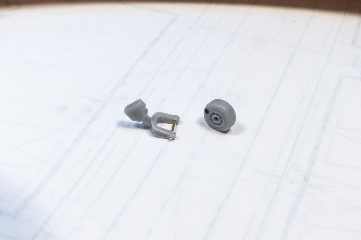

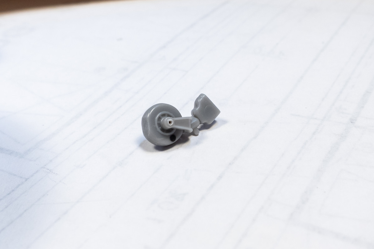

The tiny tail wheel is thoughtfully provided separately from the tiny tail strut. Curiously, the wheel is keyed into to a definite position even though the wheel is not weighted.I wanted to add flat spot to the tail wheel so I decided to incorporate an axle using brass tubing.
The tabs on the strut are cut off and replaced with holes to accommodate the axle. And a small hole is drilled through the tail wheel.
The key hole on the tail wheel, which is no longer needed, is filled in with black CA glue.
These components can now be painted separately. When it comes time to install the landing gear, the tail wheel can be rotated so that the flat spot is in the right place.
